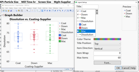

Hi, I am trying to find the option to merge legends; as merging the line with the marker of the same legend. There used to be an option in legend settings in earlier versions of SAS JMP, but I cant find it in version 19.0.

In which feature is your legend ? Graph builder ?
I am using JMP 17.2.0.
Here is an example from graph builder, with one part of the legend from the markers and one other part from the box-plots (lines).
To remove some parts of the legend : right click on the legend > untick the boxes
I hope it can help you.
Elodie

It is in Graph builder!
What I am trying is to have both the line style and the marker style as one in the legend, instead of twice as you show in the figure.
Best, Filis

I've struggled with this as well -- one possible tip for you, if you start with the line, then shift click the points it seems to only draw one set of items in the legend whereas if you click the points first and then add the lines, it creates two sets in the legend.  Not sure why the order matters, but that's what has worked for me.
