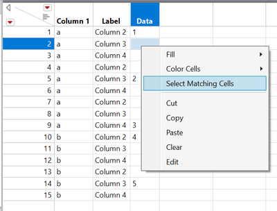

Stack your last 4 columns using the Batch # as the group variable.

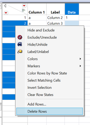

In the new table, right click the empty cells and delete the rows containing empty cells.

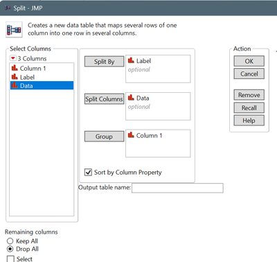

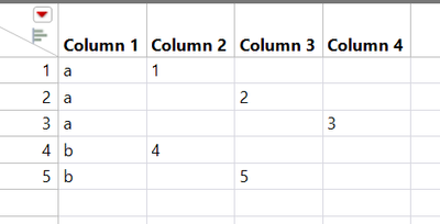

Split your table again using Batch as the group.
