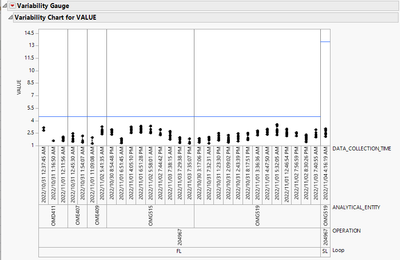

This can be done most likely much easier with graph builder than with variability chart, but if you want to use variability chart below is oversimplified example using graphic scripts
Names Default To Here(1);
dt = Open("$DOWNLOADS/test.jmp");
dt << Delete Rows(Loc(dt[0, "OVL_UDL"], "BC1_BM3"));
var = Variability Chart(
	Y(:VALUE),
	X(:Loop, :OPERATION, :ANALYTICAL_ENTITY, :DATA_COLLECTION_TIME)
spec_table = dt << Summary(
	Group(:Loop),
	// N Categories(:UP_CONTROL_LMT), // could be used for sanity check
	Min(:UP_CONTROL_LMT),
	Freq("None"),
	Weight("None"),
	statistics column name format("column"),
	Link to original data table(0),
	invisible,
	output table("spectable")
specs = Associative Array(Column(spec_table, "Loop"), Column(spec_table, "UP_CONTROL_LMT"));
groups = dt << Summary(
	Group(Loop, :OPERATION, :ANALYTICAL_ENTITY, :DATA_COLLECTION_TIME),
	invisible,
	output table("groups")
fl_groups = N Rows(Loc(groups[0, "Loop"], "FL"));
sl_groups = N Rows(Loc(groups[0, "Loop"], "FL"));
framebox = Report(var)[frame box(1)];
framebox << Add Graphics Script(
	Pen Color("Blue");
	Pen Size(1);
	H Line(0, fl_groups, specs["FL"]);
	H Line(fl_groups, fl_groups + sl_groups, specs["SL"]);
framebox << Y Axis(Max(15));

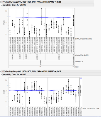

Thanks so much. I think it works perfectly except one thing. I see that you kept only one OVL_UDL value and created only one variability chart. I want a separate chart to be created for each OVL_UDL variable. In the data, there should be on for BC1_BM3 (which you have) but one more chart for BC2_BM3. I tried putting a for loop to iterate your script for each OVL_UDL but couldn't get limits to show. Any idea how we can achieve that?

Looping should work just fine, but you have to use correct limits and group sizes for each of the charts. Below is quick and dirty example (I would definitely clean this code up a lot but it should work as some sort of a starting point).
View more...
dt << New Column("PARAMETER", Character, Nominal, << Set Each Value(
	:PARAMETER_NAME || :OVL_UDL
dt_summary = dt << Summary(
	Group(:PARAMETER, :Loop),
	Freq("None"),
	Weight("None"),
dt_groups = dt << Summary(
	Group(:Loop, :PARAMETER, :OPERATION, :ANALYTICAL_ENTITY, :DATA_COLLECTION_TIME),
nw = New Window("",
	vlb = V List Box()
Summarize(dt_groups, lg = By(:PARAMETER, :Loop), lg_c = Count());
For Each({param}, Associative Array(Column(dt, "PARAMETER")) << get keys,
	var_expr = EvalExpr(var = dt << Variability Chart(
		Y(:VALUE),
		X(:Loop, :OPERATION, :ANALYTICAL_ENTITY, :DATA_COLLECTION_TIME),
		Where(:PARAMETER == Expr(param))
	vlb << Append(Eval(var_expr));
	param_idx = Loc(lg[1], param);
	param_loops = lg[2][param_idx];
	param_loop_counts = lg_c[param_idx];
	end_idx = 1;
	start = 0;
	end = param_loop_counts[end_idx];
	max_limit = Report(var)[axisbox(1)] << get max;
	For Each({cur_loop}, param_loops,
		limit_row = dt_summary << Get Rows Where(:PARAMETER == param & :Loop == cur_loop);
		limit = dt_summary[limit_row, "UP_CONTROL_LMT"][1];
		Eval(EvalExpr(
				Pen Color("Blue");
				Pen Size(1);
				H Line(Expr(start), Expr(end), Expr(limit));
		If(limit > max_limit,
			max_limit = limit + 0.5;
		Try(
			start = end;
			end_idx++;
			end = param_loop_counts[end_idx] + start;
	framebox << Y Axis(Max(max_limit));
Close(dt_summary, no save);
Close(dt_groups, no save);

Thanks. Somehow when it iterates through the OVL_UDL, it only keep correct limits on last graph. I am thinking if I can write the script to split the table into multiple tables (one for eqach OVL_UDL) and run the script through each table. How can I write a script to open one file at a time, run the plotting script, open next file and run same script again.
