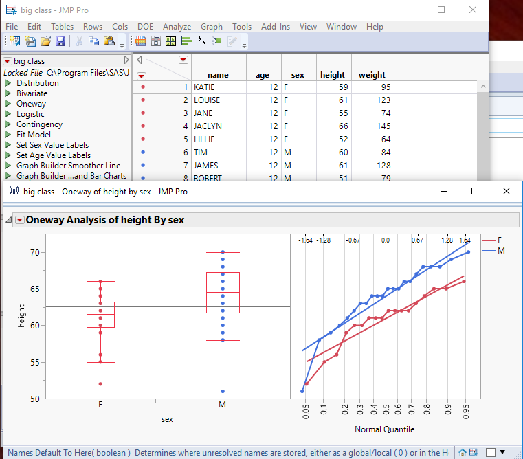

txnelson
Re: Match Line Color of Normal Quantile Plot to Row Color Set in Row Legend
I believe you can get what you want by just setting the Row State colors for the rows, and then running your Oneway.
Names Default To Here( 1 );
dt = Open( "$SAMPLE_DATA/big class.jmp" );
dt << color by column( :sex );
Oneway(
	Y( :height ),
	X( :sex ),
	Plot Actual by Quantile( 1 ),
	Box Plots( 1 ),
	SendToReport(
		Dispatch(
			"Oneway Plot",
			FrameBox,
			{DispatchSeg( Box Plot Seg( 1 ), Line Color( "Red" ) ), DispatchSeg(
				Box Plot Seg( 2 ),
				Line Color( "Red" )
Jim

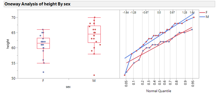

pzang
Level III
@txnelson Thank you for your reply.  However, it doesn't work for color themes other than "JMP Default".
dt << color by column( :sex , color theme("SAS Statistical"));
Oneway(
	Y( :height ),
	X( :sex ),
	Box Plots( 1 ),
	SendToReport(
		Dispatch(
			"Oneway Plot",
			FrameBox,
				Box Plot Seg( 2 ),
				Line Color( "Red" )

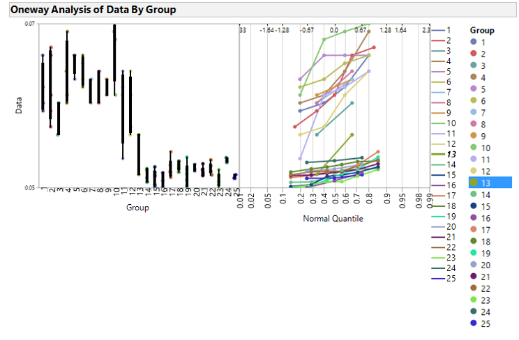

pzang
Level III
@txnelson A follow-up question:  if there are more than 12 groups, I get the following error, and line#13 becomes white:
Ceiling(i / 2) = 13;
Subscript Range in access or evaluation of 'c[3][Ceiling(i / 2)]' , c[3][/*###*/Ceiling( i / 2 )]
It seems that "SAS Statistical" only has 12 colors defined:
 N Items(Eval List(Get Color Theme Detail("SAS Statistical")[3])) = 12;
So how does JMP handle it if there are more groups than the # of colors defined in the color theme?  For example, in the plot above group 13 has a marker color different from the other 12 groups.  How does JMP determine this color?  Thanks.

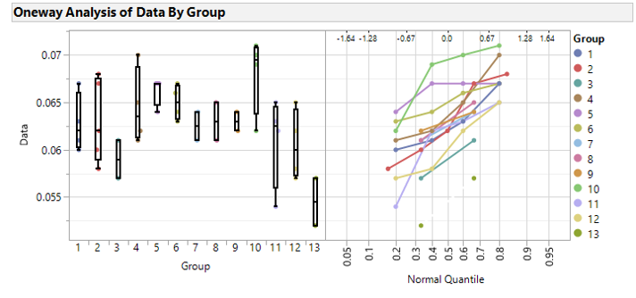

pzang
Level III
@txnelson Thank you for your suggestion.  I think I may have solved the problem.  If I only set the color of the first 12 groups and leave the rest as they are, it seems that JMP has an algorithm to generate their colors based on these 12 groups, and the generated colors match the row colors from "color by column":
pzang
Level III
Forgot to post the updated JSL function:
