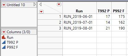

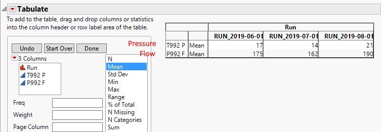

On the Tabulate platform, is there a way to change the names of columns as they are displayed in the table?  I do not want to change the actual column title in the data table itself; I just want to change the words that are displayed on the Tabulate report.
I made a simple example table to show what I mean:
I simply want to type over the column title with more descriptive words.  Similar to how one would change an axis title on a chart.  Is this possible?  As far as I can tell, Tabulate platform can ONLY display the column title.
txnelson
Re: Manually enter row title on Tabulate platform?
You can not change the data values in Tabulate.  It is a great idea, and you should submit it to the JMP WishList.
Probably the best way to do what you want, is to use the Value Labels on your column, to change the values to the desired names.  Or, you can use Recode in your data table and create a new column with the recoded values. and then use the Tabulate on the new column.
