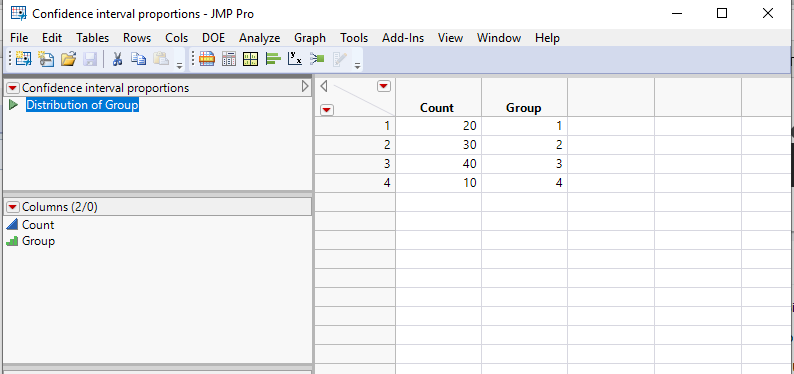

Re: How to calculate confidence intervals for multinomial proportions?
Try running the distribution script in the attached version of your data. These instructions may also help.

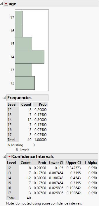

The Distribution platform will provide these intervals in a separate outline. Click the red triangle next to the name of the variable and select Confidence Intervals and the confidence level.
(Using the category age variable in Big Class for an example.)

Re: Re:
Click on the Green triangle next to the "Distribution of Group" entry in the Table Panel on the left side of the data table
Jim
Re: Re:
This short video will show how to run scripts from a data table: https://youtu.be/gz1AlTqQg7Q After watching that open the table I attached in my first reply and run the script saved to the table. If the report you get on running the script is the result you are after then open the link I gave in the first reply for instructions on creating the result you are after. This will guide you regarding the steps to take using the Distribution platform to recreate the results you are after.

Thank you, Malcolm! The instruction is important! Since I don’t practice scripts, say a few words, please, how to use your attached file.
Thank you, Mark, for pointing this!
txnelson
Re: Re:
Jim
Re: Re:
