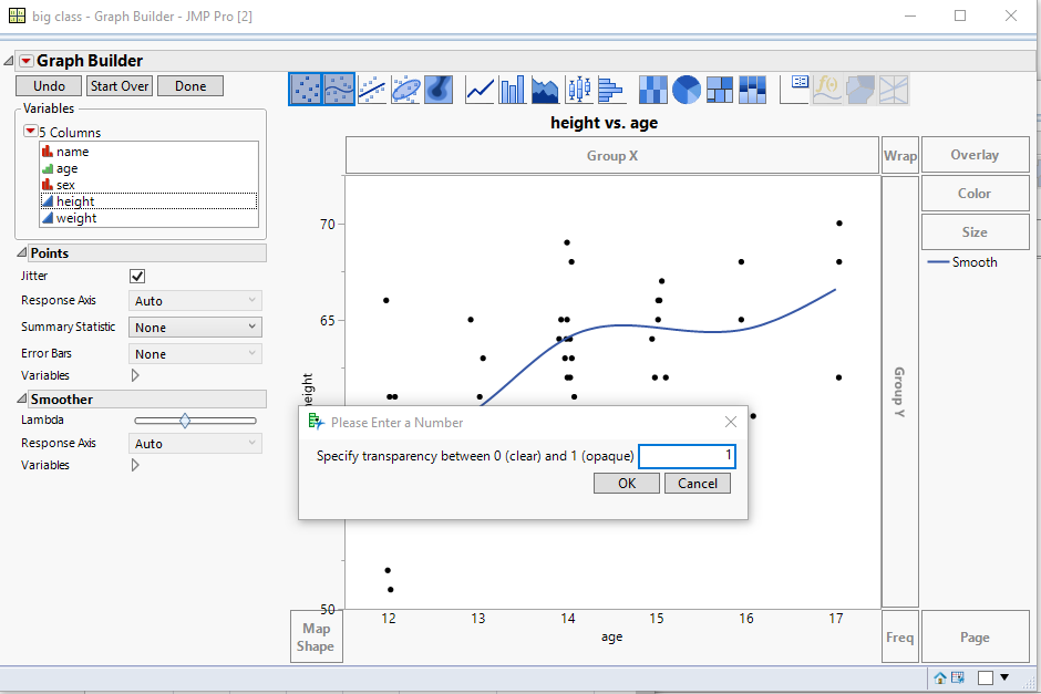

As the subject says, is there any way to make the "smoother" lines in Graph Builder transparent? Right-click > Graph > Transparency... only affects the points, not the lines.
I would like to be able to build a graph with hundreds of lines overlaid, and make those lines transparent so that they are not overplotted and it's easier to see the "distribution" of trends.
Likewise, is there a way to change the line width/style of all the lines at once? You can change individual lines in the Customize... window, but that is infeasible for hundreds or thousands of lines.

You can right click on the smoother legend and select Transparency, to change it
