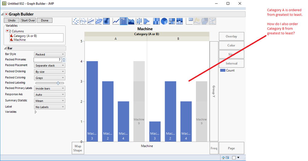

Please see the attached photograph for an example of what I want to do. I want to use graph builder to display two perato charts side-by-side when the data is broken into several categories. However, when I currently try to do this (as can be seen in the attached screenshot) JMP orders the bars by using the total amount of occurances, instead of by ordering from greatest to least for each individual category.graph_question.png

GraphBuilder is powerful, but it has a few quirks. One of the quirks is that it tries to maintain the same axis settings for the groups. From your graph, it appears that Category( A or B) is an X grouping variable and Machine is your X variable and you are using bars. As you noted you can click on the X axis and select order by Count descending, however, the order of Category B will be the same order of Category A.
There might be a control sequence to order each Category, maybe a JMP expert can help. A wish list item would be to separate group axes.  The only way I know how to get separate X axes (side by side) is to have two different variables.  This can be done interactively, by using a Transform Column() it takes a bit of clicking and renaming.  Here is the picture created using this method with Big Class.

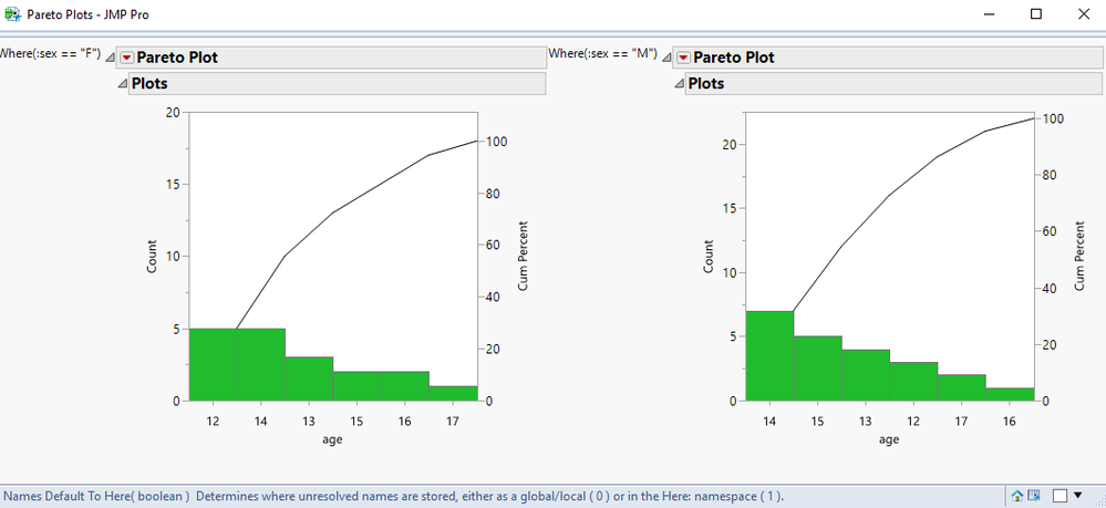

I think you may want to look directly at the Pareto Plot Platform available in JMP
     Analyze==>Quality and Process==>Pareto Plot

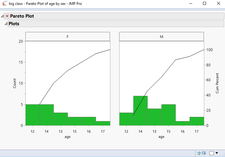

While it has the same starting limitation of using the same order in both Pareto Plots, which by the way, many prefer, because it allows for less confusing comparisons for the groups,
A very simple script can turn the graph into exactly what you want
Names Default To Here( 1 );
New Window( "Pareto Plots",
	H List Box(
		Pareto Plot( Cause( :age ), Where( :sex == "F" ) ),
		Pareto Plot( Cause( :age ), Where( :sex == "M" ) )
