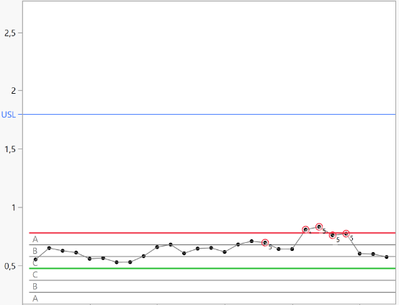

On the control charts, I want to exclude the zones over the average when there is no lower limit.

*below the average not over the average .
example :
Here you can see that there is no LCL, thus i want to remove the zones below the green line, but i want to keep the zones above the green line. Also, when i have points on the A zone below the average, I don't want to have alerts because there is no LCL. Does someone knows how to do it?

I think this would require to you script those zones and shaded zones (it might be easier to do this in Graph Builder rather than in Control Chart Builder)
