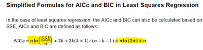

  • The AICc formula uses the likelihood, which is based on the normal density function with Sigma, whose MLE is sqrt(SSE/N). The first term in the following screenshot is the contribution from Sigma's MLE. In such sense, when computing AICc in this way, the number of parameters must count Sigma in addition to regression coefficients.

Maybe this page can help: https://www.jmp.com/support/help/en/15.1/index.shtml#page/jmp/likelihood-aicc-and-bic.shtml#ww293087
Scroll down to the bottom to see the formula related to least squares.
Notice the relationships among the pieces in three sets of formula:
(1) from the top half of that page
(2) from the bottom half of that page
(3) from the thread that you point to
So the -2Loglikelihood in (1) equals the two highlighted pieces in (2).
And the -2Loglikelihood in (1) and (2) are different from (3) by a constant N.
In other literature, you may see -2Loglikelihood = N*log(SSE/N). I am glad that you notice the difference. It is common in the literature that constants in loglikelihood get dropped off.

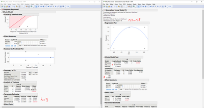

Thanks for pointing that out @modelFit ! This was the option I was looking for. For my data, I get the same LL as with statsmodels - which confuses me even more. Maybe my issue becomes more clear with a screenshot (I hope the resolution is high enough) of my problem:
Therefore, I have the following results based on JMP 16.2.0:
  • -LL = 8.3501
  • k = 3
  • n = 18
  • AICc = 27.7869
However, if I use -LL, k and n to calculate the AICc manually (formula (1)) I get 24.4243 -> I get the same result with statsmodels.
If I use JMPs AICc and re-formulate the formula to LL= (2k+2k(k+1)/(n-k-1) - AICc)/2 I get an -LL of 10.036.
Something doesn't add up, or am I missing something?
