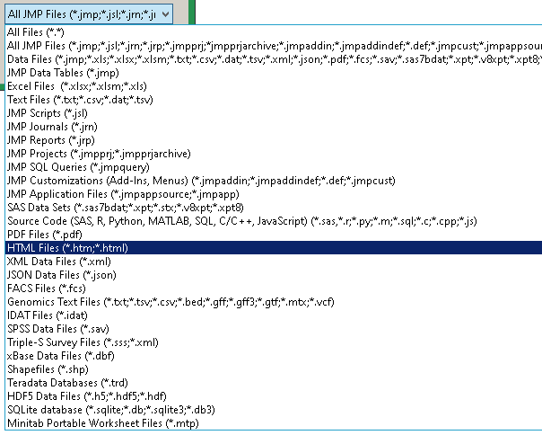

Without JMP installed you can't create a .JMP data table (which is a binary format.)
You can create a .JSL file (text) that will open as a data table. You can also create other formats JMP will open, including .CSV, .JSON, etc
Some of these formats are for data.
