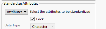

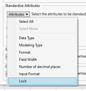

You can also do this interactively.
Select all your columns, right click, standardize attributes
From Attributes select lock
Enable Lock, press Apply, verify from column list columns are locked and press OK
JMP will also create a script to do this but it isn't as robust as the script provided by Jim (JMP created one has pre-determined columns in a list)

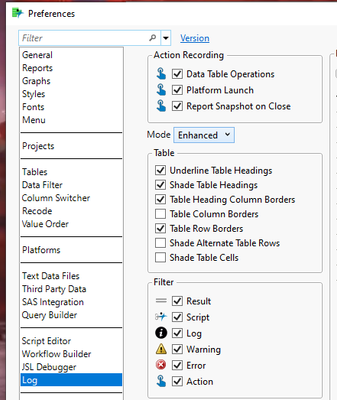

How do you see this JMP created script?
jthi
Re: Locking all columns in JMP
You have to have Log mode as Enhanced (I think this might be enabled by default since JMP JMP16/17+?)
Then you can open the Log (press Ctrt+Shift+L or View/Log).
