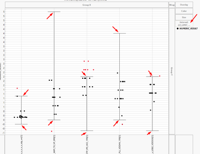

Hello
Sometimes I use limits in graph builder, which shows me the limit lines on the graph
but I didn't find the option to show me the number of limits (minimum and maximum) in this graph.
Can you address how I can show the number of the data of the limits on my graph?

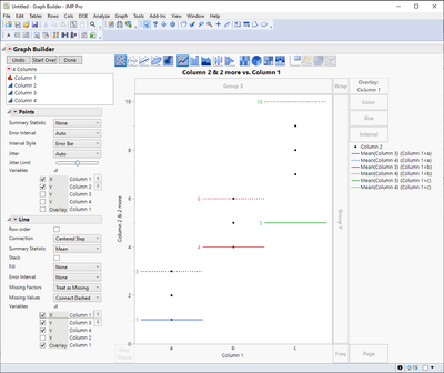

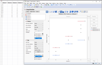

One more option is to use float bar chart (or line chart) for the limits
-Jarmo

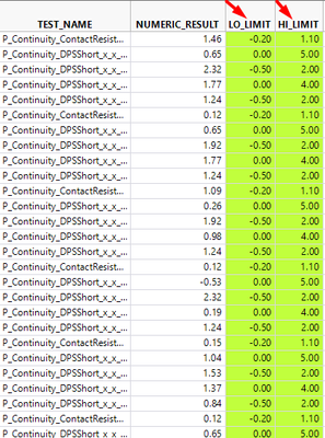

I think, if you could share a copy of a data table including the graph builder table script, that would be really useful.

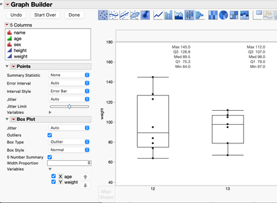

Does the '5 Number Summary' give you what you want?

It's not assisting me because I needn't a plot box.
For example, I have a lot of test names, and each test name has its own limit.
Actually, I have found the option to add limits lines by graph builder > interval
But the graph just adds limits lines and not the info of LO_LIMIT and HI_LIMIT on these lines.
I will very much appreciate it if you can address me where I can add the info to my graph which limits it is?
-Jarmo
