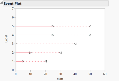

I assume that censor = 1 means that the life time is censored. Given that interpretation, you are not using the start and end values properly. If you use interval censoring, Life Distribution ignores the censor variable. Entering an interval indicates a failure event in that interval. If the observation is right censored, then life goes in the starting column and missing goes in the end column. A left censored life value goes in the end column and missing goes in the start column. An exact failure time is entered in both start and end columns.
I think that this way should work:
That leads to this event plot, which seems correct to me if I interpreted your data correctly:

You are not using interval censoring properly. If you enter 0 and 40 for observation 3, you are telling JMP that the failure occurred in this interval of time. If it is uncensored, then enter 40 for both start and end so that JMP knows it is an exact life.
It doesn't matter when the subject life began. It is assumed that all begin at life = 0. The question is how do you indicate the life value?
Most cases involve only right censoring, so Life Distribution makes this special case easy. You enter the life value and, if present, the censor value. All other cases (left censoring, interval censoring) use two life values. See this example in which life is observed every 10 time units for the different kinds of censoring when using two life data columns:
This data results in the following Event Plot in Life Distribution:
