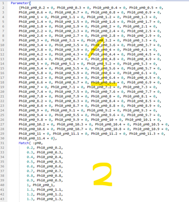

I see the number of parameters after launching the Nonlinear. There is a able of parameters. I right click and create a table out of it, count rows. For the last two rows, I would suggest just edit the JSL formula. Open up the formula editor of the column. Copy it, and paste into a JSL editor. After editing, copy and paste back. By such, you can edit the list of parameters:
The "1" section is your list of parameters. The "2" is the actual formula.

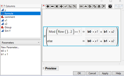

I attach v2 of the "nonsense system". First explain what I set up.
I set up two systems of linear equations. Row 1 and 2 are system "a", the Group column. And row 3 and 4 are system "b".
Each linear system has two parameters "b0" and "b1", but they are different between systems. And I use the parameters, x1, and x2 to produce "SimY". I copy SimY to Y for my analysis.
Now look at the "formula" column, I do not differentiate "b0" ad "b1" by Group.
Now run Nonlinear with By = Group. And here is the report:
It finds separate, correct, solutions for respective systems.
