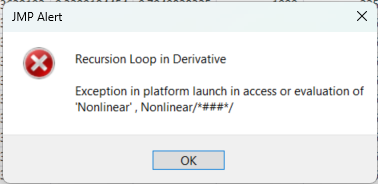

I've put together a table and it seems to work if I have a couple of rows, but if I try to do more than a few, it gives me this:
Is this indeed an issue with just having too many rows? The error seems to persist if I cut down the rows to the minimum (3 in this case) and I have to go make a new table. Do you have any thoughts on this? Here's the table I've made with a barebones version of the model so its not cumbersome. I've also put the parameters into their own columns (Phi0, sigma0, pHf) and expanded intermediate formulas to make looking at the column formula easier.

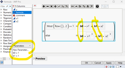

But if "Formula" column is X, I don't think it would work. The formula of X must use Parameters, not Table Variables.
The following is what the X column looks like in that "nonsense data table".
Your "Formula" column does not have anything listed under Parameters.

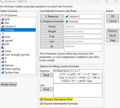

Hey @peng_liu - Yea so because the parameters were making the formula 100 times as long, I dumped them into the Phi0, sigma0, and pHf columns (columns 6-8 after the column with a "." as the title), and then was selecting the "Expand intermediate formulas" box at the bottom of the nonlinear platform. That way I can use the parameters but they aren't making the formula column impossible to work with, since there are so many "expanded categories" for each parameter.
Does that make sense?
The attached screenshot should show those columns and their location in the formula, in case that makes it clearer.

@peng_liu I will also say that I've found that 1) numerical derivatives only option does seem to get it to go through to the main platform, and 2) that when I have parameters in more than one of the equations, it seems to give that error. Not sure if that tells you anything. I just can't find a reference to that error so I'm stumped.

I looked at the error message. You need to check "Numerical Derivatives only".
You have 300+ parameters, the underlying symbolic derivative is hitting a limit.
I see you have 337 rows, but 339 parameters. This subset won't get a solution. Hope your full set does not have the issue.
