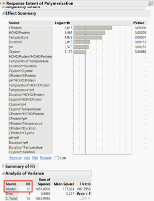

So on the total of 17 runs, you have only 13 unique runs (17-4 duplicate rows) that you can use to fit a model, so 13 degrees of freedom. One of this DF is allocated to the intercept, so you're left with 12 degree of freedom. You can check this by fitting an overly complex and saturated model to the data, and see in JMP platforms the number of degree of freedom allocated to the model :
You can see that the 4 centre points duplicate rows are used to estimate error from the model. With the 12 DF allowed for model estimation, you could fit 12 terms in the model.

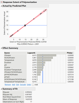

Here are the results with a saturated model (12 terms) :

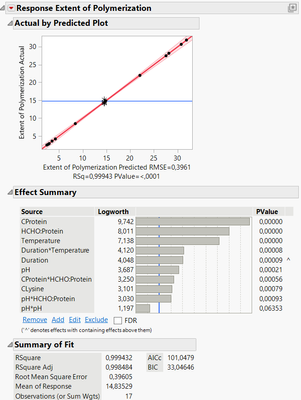

Here is a more parcimonous, yet effective, model :
