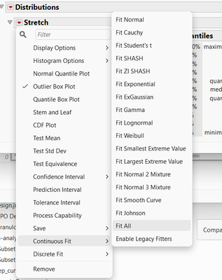

To test the type of distribution if your data, you can simply use the platform Distributions, and in the red triangle options of the data, you can choose "Continuous Fit" and select all or only specific type of distributions :

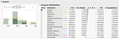

If you have selected several distributions or all, you will have a first comparison view of the distributions with the AICc criterion :
If you want a statistical test, simply select the distribution you want to test, and in the red triangle of this distribution select "Goodness of Fit" :
For continuous fits, the goodness-of-fit test is the Anderson-Darling test : Fit Distributions

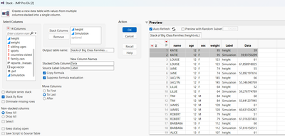

  1. Generate a random formula column with the correct distribution in your datatable (in my case I'm using the dataset Big Class Families, and creating a new column with a Weibull formula distribution to compare it with the "Height" column) :
  2. Stack the generated data with the column you want to test, adding a label and values to differentiate "real data" to "simulated data" :

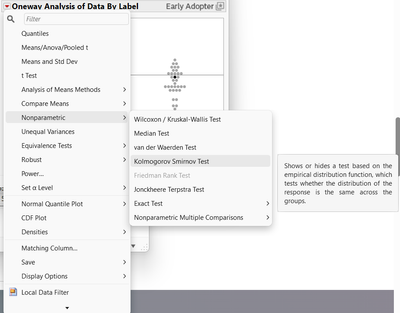

  3. Use the platform Fit Y by X, with the data as Y and the label/distribution type (real/simulated) as X :
  4. In the red triangle, in "Nonparametric", choose "Kolmogorov-Smirnov Test" to compare your simulated data with the real data:
    You'll then have the statistics displayed for this test : Nonparametric Test Reports
