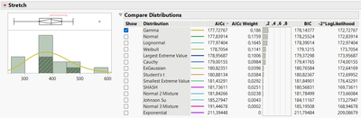

To test the type of distribution if your data, you can simply use the platform Distributions, and in the red triangle options of the data, you can choose "Continuous Fit" and select all or only specific type of distributions :
If you have selected several distributions or all, you will have a first comparison view of the distributions with the AICc criterion :
If you want a statistical test, simply select the distribution you want to test, and in the red triangle of this distribution select "Goodness of Fit" :
For continuous fits, the goodness-of-fit test is the Anderson-Darling test : Fit Distributions
If you want to compare two distributions using Kolmogorov-Smirnov Test, then the platform Oneway Analysis in Fit Y by X menu may help you : The Oneway Platform Options
Hope this answer will help you,

You could then use the first option I described using Distribution platform to estimate parameters for the distribution you intend to test. Then create a random formula column with the distribution and estimates found earlier, and then follow the procedure of my second reply to do the KS test to compare simulated data and measured data ?
But I think the Anderson-Darling test available in the Distribution platform is the most direct option, and very close to what you intend to do.
