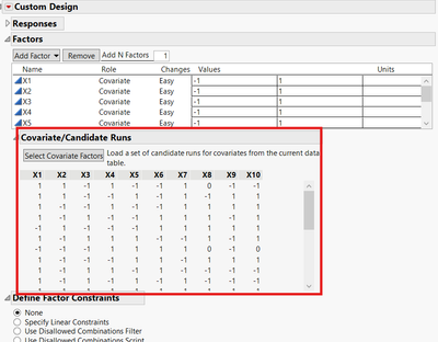

    1. First, create the CCD design with replicates.
    2. Then, use the Custom Designs platform and select your covariates Factors to import your design table :
    3. You can then add a blocking factor in the "Factors" panel for the labs, check the option "Include all selected covariate rows in the design", and "Make design".
This way, your CCD Orthogonal design with replicates could include a blocking factor to take into account possible day-to-day variation.
