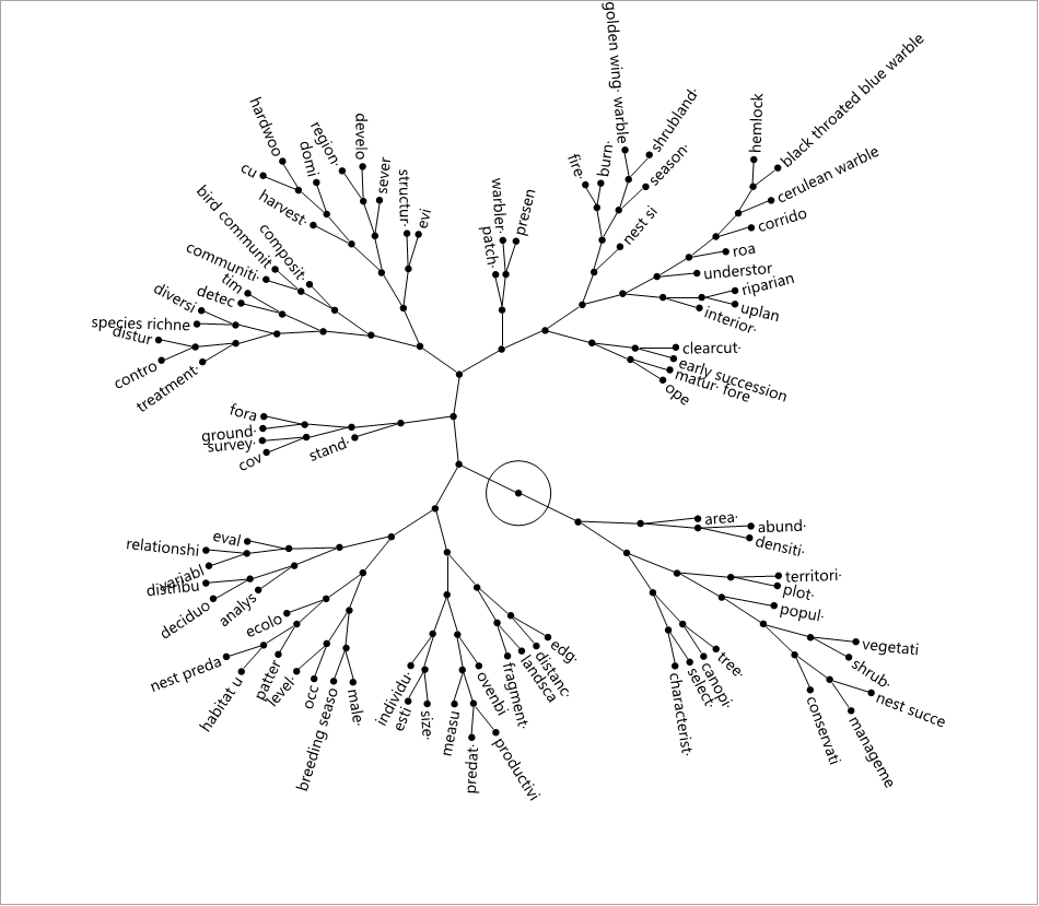

Very nice!

The problem appears to be JMP 15 vs 16; you can make your own label column instead:

Since I added a label column, I had to accout for it in the column list.
There is no real difference between this display and the normal cluster dendogram display; the circled node in this diagram is the root of the dendogram and everything else is just fanned out in a circular pattern. This is easier to read. You might need to tell your audience to use the length of the connecting path between words (not just proximity) as a measure of connectedness.
You'll also want to play with the text explorer part; the stop words I used were specific to the Project Gutenberg document boiler plate in every book, and the word length of 6, and the stemming choice might not be optimal for your docs.
Edit: and combine some words maybe: northern, southern, western, eastern might all mean the same thing for your purpose?

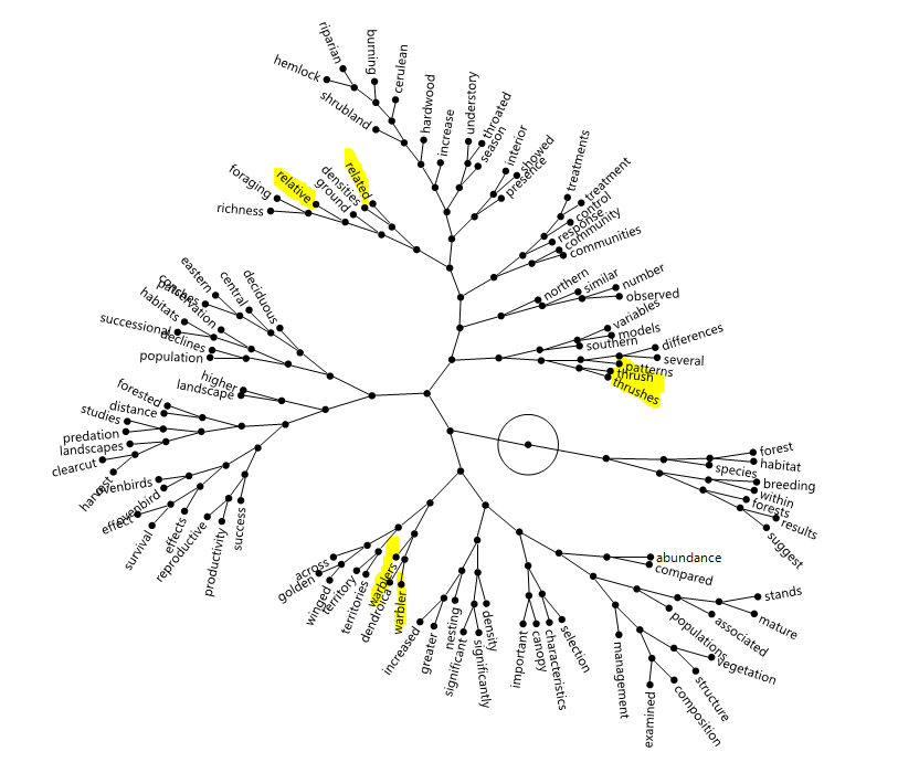

Hi Craige, Worked like a charm! Thank you. I've attached my graphic below. Since I've saved all of my corpus curation steps as column properties (recodes, phrases, stop words, stem exceptions) they get applied automatically when the script is run. I'll start experimenting with some of the parameters to see how they affect the resulting graph. I have a lot of applications where this kind of graphic is helpful, at least during the data exploration phase, so I will use this script over and over. Thank you again for all of your help!
