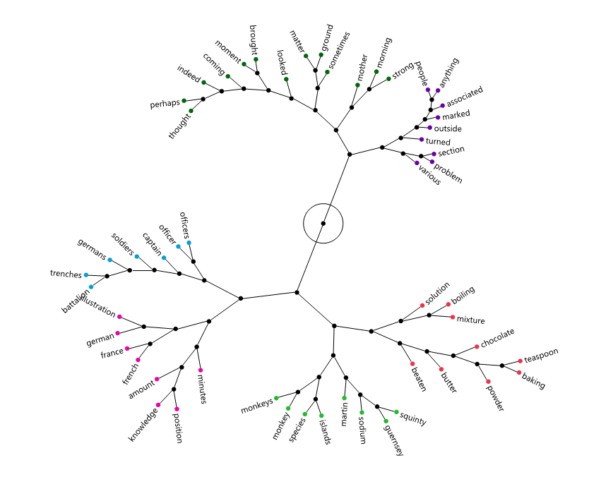

This isn't really it either, but maybe closer. I colored these by selecting a root node in the branch and then coloring the selected rows in the data table. It took a bit of hand-curating the stop words to make a pretty picture.
TransposedTransposed
// load some documents that might separate into some categories
dt1 = Open( "f:/gutenberg/books5000.jmp" ); // 5000 is too many, subset 36...
dt1 << selectwhere(
	Starts With( Loc Class, "D501" ) | Starts With( Loc Class, "TX:" ) | Starts With( Loc Class, "Q" ) | Starts With( Loc Class, "P" )
dt2 = dt1 << subset( selected rows( 1 ) );
Close( dt1, nosave );
originalnames = dt2 << getColumnNames();
te = dt2 << Text Explorer(
	Text Columns( :text ), // the entire document is in one cell of the row
	Add Stop Words(
		{"agreement", "almost", "another", "company", "copyright holder", "electronic", "foundation", "gutenberg", "literary archive", "little",
		"person or entity", "project", "public domain", "research", "without", "ebooks", "enough", "though", "rather", "better", "common", "possible",
		"weight", "present", "series", "necessary", "placed", "therefore", "towards", "footnote", "something","slowly","around","behind","looking","seemed","nothing",
			"probably","called","easily","distributing","paragraph"
	Minimum Characters per Word( 6 ),
	Stemming( "no stemming" ), //"Stem for Combining"
	Language( "English" )
//te << savedocumenttermmatrix( Maximum Number of Terms( 300 ), Minimum Term Frequency( 25 ), Weighting( "TF IDF" ) );//BINARY would use ALL rather than !any, below
te << savedocumenttermmatrix( Maximum Number of Terms( 100 ), Minimum Term Frequency( 25 ), Weighting( "BINARY" ) ); // 0 or 1 if it occurs
te << closewindow;
// remove all-connected columns
allnames = dt2 << getColumnNames();
For( iname = N Items( allnames ), iname > N Items( originalnames ), iname -= 1,
//	If( !Any( dt2[0, iname] ),
	If( All( dt2[0, iname] ),
		dt2 << deletecolumns( iname )
cols = (N Items( originalnames ) + 1) :: N Items( allnames );
//dt2 << Hierarchical Cluster(	Y( allnames[cols] ),
//	Label( Transform Column( "Label", Character, Formula( Left( left(LoC Class,4)||:Subject||:Title, 20 ) ) ) ), // build your own identifier here
//	Method( "Ward" ),	Standardize Data( 1 ),	Dendrogram Scale( "Distance Scale" ),
//	Number of Clusters( 4 ),	Constellation Plot( 1 ),	Show Dendrogram( 0 ),
//	SendToReport(Dispatch({"Constellation Plot"},"Clust Hier",FrameBox,{Frame Size( 1056, 716 )}))
dt3 = dt2 << Data Table( "Subset of books5000" ) << Transpose(
	columns( allnames[cols] ),
	Label( :Title ),
	Label column name( "Title" ),
	Output Table( "Transpose of Subset of books5000" )
dt3 << Hierarchical Cluster(
	Y( (dt3 << getColumnNames)[2 :: N Cols( dt3 )] ),
	Label( Transform Column( "Transform[Title]", Nominal, Formula( Left( :Title, Length( :Title ) - 7 ) ) ) ),
	Method( "Ward" ),
	Number of Clusters( 13 ),
	SendToReport( Dispatch( {"Constellation Plot"}, "Clust Hier", FrameBox, {Frame Size( 948, 827 )} ) )
Craige

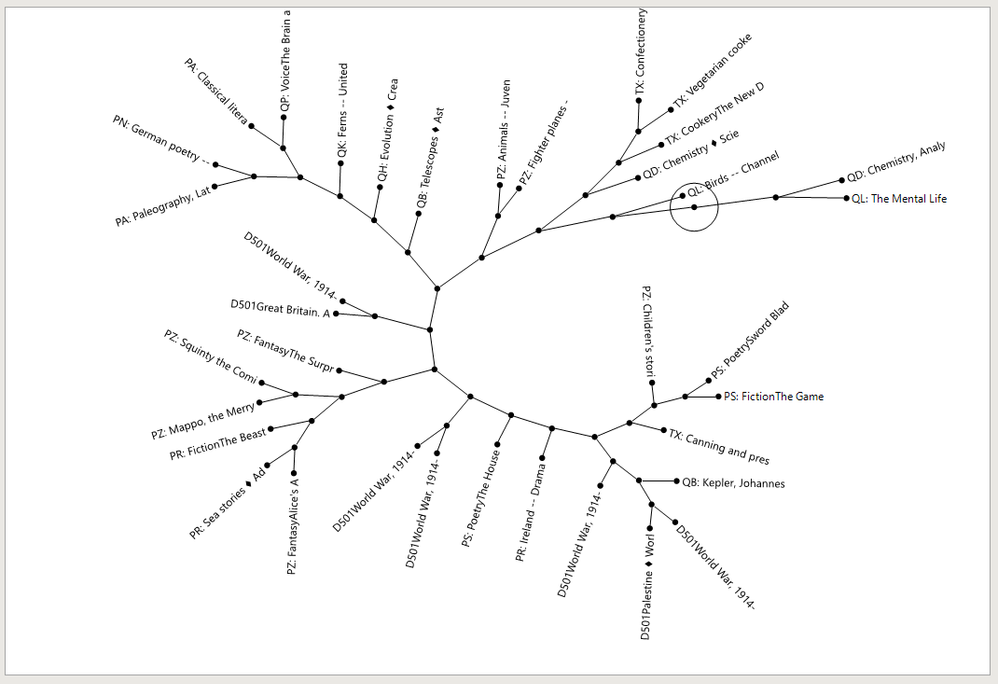

You can get something related, maybe, like this. And it is connected to the table. And not Pro.
Constellation Plot from ClusteringConstellation Plot from Clustering
dt1 << selectwhere(	Starts With( Loc Class, "D501" ) | Starts With( Loc Class, "TX:" ) | Starts With( Loc Class, "Q" ) | Starts With( Loc Class, "P" ) );
	Add Stop Words(
		"person or entity", "project", "public domain", "research", "without"}
	Stemming( "Stem for Combining" ),
te << closewindow;
Craige

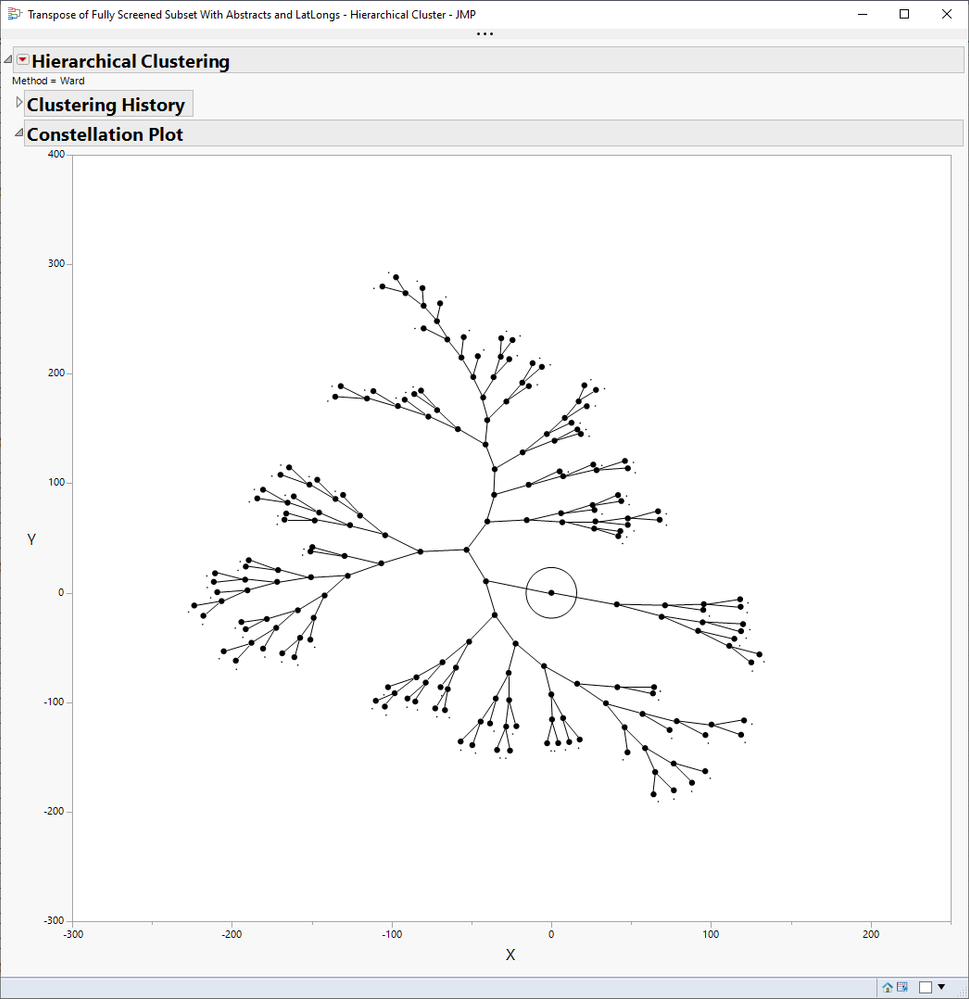

I just realized that the script you sent uses values in a DTM to create clusters of documents based on similar uses of terms among documents. In this case, each node represents a document and each link is based on a distance value from cluster analysis. I'm trying to do something slightly different.
I'd like to create a constellation graph like this where each node represents a TERM in the DTM and each link is based on some sort of statistic that describes keyword co-occurrence. This is way outside of my expertise. I love the idea of such a plot, but I'm not sure if it would be appropriate to reformat the DTM somehow so that a cluster analysis could be done where terms end up as nodes (or how I would do this). This would accomplish my goal of having a graphic in JMP based on term relatedness that I can use as a global filter in an interactive data visualization. However, would this sort of end-around create a graphic that is not based on best practices of text analysis? For those of you that understand this field, would this use of cluster analysis be inappropriate to illustrate keyword co-occurrence? If so, has anyone built anything that can do keyword cooccurrence analyses (using proper statistical methods for this type of analysis) in JMP?  I'm interested in hearing feedback from the community on this. I apologize that my original post wasn't clearer. Craige, I will definitely use the script that you sent in your first response for when I need to cluster documents! Thank you.

Craige_Hales
Re: Keyword cooccurence networks in JMP?
dt1 << selectwhere(
	Add Stop Words(
te << closewindow;
	Label( :Title ),
	Method( "Ward" ),
Craige
caseylott
Level V
Hi Craige,
That's it! I modified the script you sent for my data table (see attached script and table file). Everything worked great, but I couldn't get the label function to work. I looked at it 3 times and I swear I'm copying your code exactly. Do you see anything that could be keeping it from working? The plot image that I get is below. As you can see, the term labels are shown only as dots. Thank you again. I really appreciate it!
