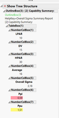

I noticed from the "tree structure" following structure (for the table above):
So I'm guessing the line would incorporate something like the following: "Report(CAPREP)[OutlineBox(3),NumberColBox(5)] << ...", however so far without success.

Hi Jonas,
You're very close.  In this case, you referencing the NumberColBox is sufficient, you don't need to reference the OutlineBox.  Try this:
PPL_VALUE = Report(CAPREP)[NumberColBox(6)][1];
PPU_VALUE = Report(CAPREP)[NumberColBox(7)][1];

Re: Changing/reading a specific value from a JMP generated (capability) summary table
Thanks Hadley!
Script works.
Note: I noticed different values were generated with NumberColBox 6 and 7... With some trial & error I came up to this;
SIGMA_VALUE = Report( CAPREP )[Number Col Box( 9 )][1];
PPL_VALUE = Round( Report( CAPREP )[Number Col Box( 12 )][1], 2 );
PPU_VALUE = Round( Report( CAPREP )[Number Col Box( 18 )][1], 2 );
