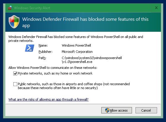

I think this was required, but can't be sure after a couple of false starts...
Dialog from windows to allow PowerShell to open a port.Dialog from windows to allow PowerShell to open a port.
And eventually
Right-click the .PS1 script on the desktop and ->Run in PowerShell.Right-click the .PS1 script on the desktop and ->Run in PowerShell.
