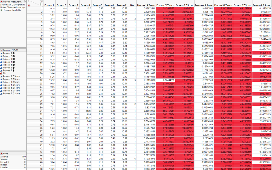

Here is a sample script, that creates the Z scores and identifies the values that are greater than 3.  Is this in the direction of what you want?

I wasn't clear with my previous issue. I would like to find a single units z-score for every test based on the the entire dataset's distribution. Because of this, I can't just subset the ECID's of note. Secondly, I'm not sure the original script is working correctly. Upon further review, I've noticed that many of the z-scores are unlikely. There are some z-scores that are nearing triple digits.
