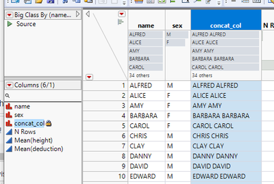

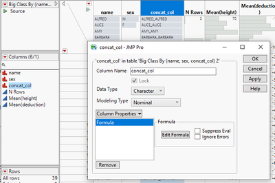

Formula not visible in column listing on the left and formula not visible in Formula panel box either.

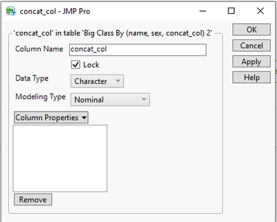

The formula is there if I click Edit Formula. And if I change "_" in concatenate to " "  the formula disappears, column gets locked and values do get changed in datatable:
