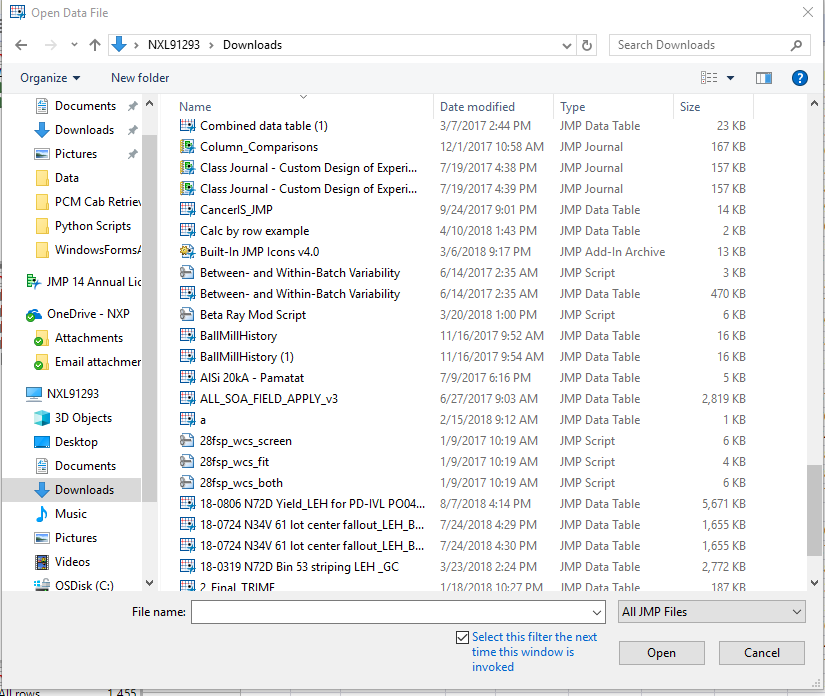

I am able to run the attached script after I have accessed this file using the graphical "open file" window in JMP.  I think this works because sharepoint now knows that JMP is authorized to access the excel file.  I had the work around idea to have JSL call the graphical open window, wait for the user to input the file they want, and execute.  The hope is that the magical "Windows Security" window opens and they can enter their credentials.
Does anyone has experience with this?  Is there JSL to open that "open file" GUI?

Is this the "graphical 'open file'" window you are referring to?
If so, then the following JSL code is all you need to open a file
Names Default To Here( 1 );
file = Pick File(
	"Select JMP File",
	"$DOCUMENTS",
	{"Excel Files|xls;", "All Files|*"},
	1,
	0
dt = open( file );
Jim

Thanks for providing that. "Pick File" is exactly what I am looking for.  I do have a follow-up question about how this function works though.
I would really like to provide the user with the path and excel file in the open window.  It seems though that JSL is not reading the punctuation correctly for the path.
For the attached script the path displayed in the window is:
JSL issue.PNGhttps---xyzcomp.com-sites-SbD-Product-docs-Development%20Database-Feasibility
Why has JSL replaced all ":" and "/" with "-"?  Is there a way to prevent this?

Pick file only works when looking into an operating system file structure.  The Open Window Object does not understand URLs.
Jim
