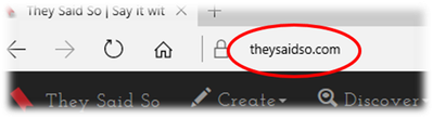

The second is GET -ting (accessing) a resource, along with what is known as a query string. A query string is a set of key/value pairs defined by the web resource and used by the client to request the server to filter or modify the GET request using these parameters. This can be seen in Figure 2. Here browser is asking the server to modify a GET request using:
  • q=jmp
    Figure 2. “ GET using a query string for web resource”

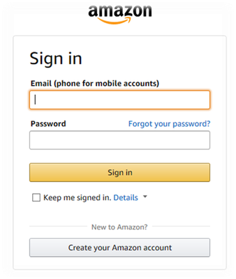

POST , on the other hand, is more complex. A POST asks the server to change or create a resource. A POST typically contains an HTML Form which in turn contains a collection of key/value pairs of character data and/or key/value pairs of files. Figure 3 is an example that signs a user into Amazon. Here the key/value pairs are:
Email
Your email sign in
Password
Your password
The “Sign in” button performs the POST
Figure 3. “ POST form data to a web resource”

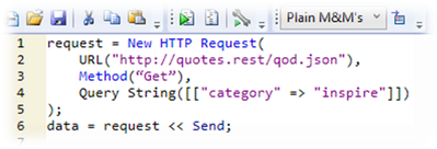

HTTP Request GET actions are often accompanied by a “Query String” to send parameters to a web resource. Figure 5 uses an HTTP Request with a “Query String” . In JSL, a “Query String” is an Associative Array that maps a key to a character value or a List of character values. When the script in Figure 5 is run, the URL will be automatically expanded to:
http://quotes.rest/qod.json?category=inspire image009.pngimage009.png
Figure 5. “ HTTP Request GET using a ‘ Query String’

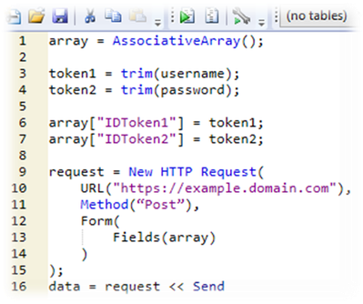

Figure 6 shows an HTTP Request Form” data. In JSL, “Form” data can have two attributes, “Fields” and/or “Files” . They are both JSL Associative Arrays that map a key to a character value or a List of character values. In the case of the “Files” , the character value or List of character values are the filenames that you want to add to the “ Form”.
Figure 6. “ HTTP Request POST using a Form

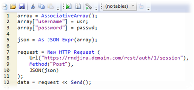

Figure 7 shows an HTTP Request JSON” data. In JSL, “JSON” can be either an Associative Array or character data in JSON format. As JSON Expr will create a well-defined JSON object to use with HTTP Request . JSON data is sent as the body of the request. image013.pngimage013.png
Figure 7. “ HTTP Request POST using ‘ JSON’

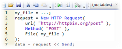

Figure 8 shows an HTTP Request File” data. In JSL, “File” is the filename you want to send as the body of the request. image015.pngimage015.png
Figure 8. “ HTTP Request POST using ‘ File’

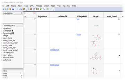

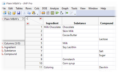

I wrote a JSL script that created a JMP data table of the ingredients of Plain M&M’s to see what is in them. It was no surprise that the ingredients were heavy on the artificial coloring.
A JMP partial data table representation looks like this: image019.pngimage019.png
Figure 10. “Partial Plain M&M ingredient data table”

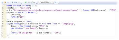

To retrieve the image data of a compound like Lactose, the HTTP Request looks like: image023.pngimage023.png
Figure 12. “ GET -ing the image of Lactose from PubChem”
image025.pngimage025.png Figure 13. “ GET -ing and displaying the image of Lactose from PubChem”

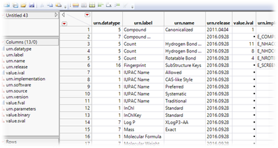

A partial display of the JSON Data for Lactose looks like: image029.pngimage029.png
Figure 15. “Partial Lactose JSON data from PubChem”
This editor displays a side-by-side representation of raw JSON with corresponding JSON object. When you examine the data, a {..} in JSON, think JSL Associative Array . Likewise, when you encounter a [..] think JSL List .

The first personality is just GET -ting a resource. That is, the intent is merely accessing a web resource. This can be seen in Figure 1. Here, the browser is accessing the webpage. image001.pngimage001.png
Figure 1. “ GET for a web resource”

POST
Email
Your email sign in
Password
Your password

Figure 4. “ HTTP Request GET
Figure 9. “Plain M&M ingredients”
The Lactose request uses PubChem’s endpoint for compound. There are two additional concepts used here. The first is Encode URI . URI encoding, also known as Percent Encoding, ensures that the RESTful URL contains only ASCII characters (luckily Lactose does). The second concept is “Get MIME Type” . The return from this PubChem endpoint is a binary blob data (a PNG picture). The “Get MIME Type” check ensures that the blob is indeed a PNG before it used with New Image since this endpoint will return character data if no PNG is found.
