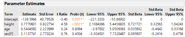

Thanks so much for this! This seems to be exactly what we're looking for. We're using JMP 14.1, but for some reason, the script will not function properly. I am not sure if we're just not using it correctly.
The data file opens as expected, but the columns for the standard beta CIs are not displayed for some reason when I run the script. This is without making any modifications to have it work on my own table - just using the "Big Class" example table. I suspect I am making some kind of amateur error here. I've attached a screenshot of the output I get. Do you have any idea what I might be doing wrong?
Thanks again for all the help, I really appreciate it!

First of all, when I run the script and the confidence intervals appear in the display tabl, when I use the interface to look at the columns those new column will not appear, because the interface you used is built-in and only lists the built-in columns.

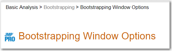

Second, I have JMP  Pro 14.1. From the online help, it seems Bootstrap is only available on JMP Pro.   That might be the issue.
If you have JMP PRO, to determine the error, I'd need to see the log. To view the log, CTRL+SHIFT + L. Right click and select Clear Log, then run the script again. The Log should report any error.
