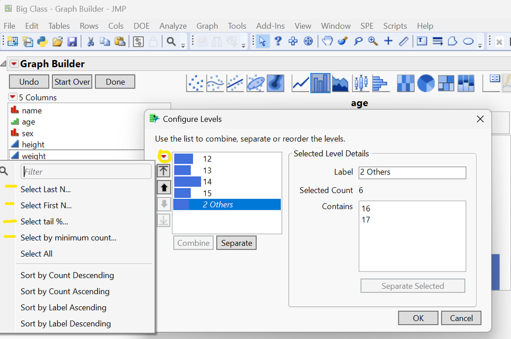

tom_abramov
Level V
Re: JSL for "Configure levels"
Thank you for your response.
There are this super useful options in "Configure Levels" like tail%, min count etc.
One can create a new column with formulas, but since the options already exist, please add JSL commands for them. Screenshot 2024-04-28 091846.png
