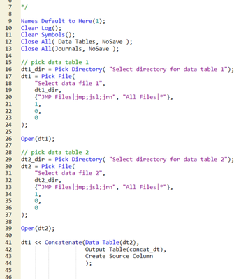

Hi All,
I'm a new user in JMP scripting and need help to find bugs in my code.
What I'm trying to do here is to concatenate already opened data files (dt1 and dt2). I found that the script did not concatenate the two tables. line 41 and so on was not executed plus with no error message
Can anyone help me with it?
Thanks

This works fine:
Names Default To Here(1);
dt1_dir = Pick Directory("Pick dir", "$SAMPLE_DATA/");
dt1 = Pick File(
	"Select JMP File",
	dt1_dir,
	{"JMP Files|jmp;jsl;jrn", "All Files|*"},
	1,
	0,
	0
Show(dt1);
dt1 = Open(dt1);
Show(dt1);
dt2_dir = Pick Directory("Pick dir", "$SAMPLE_DATA/");
dt2 = Pick File(
	"Select JMP File",
	dt2_dir,
	1,
	0,
	0
Show(dt2);
dt2 = Open(dt2);
Show(dt2);
concat_dt = dt1 << Concatenate(dt2,
	Output Table("Concat datatable"),
	Create Source Column
Do similar changes to your code and check if it works (check Concatenate())
-Jarmo

jthi
Re: [JSL Bug] Got problem when try to concatenate two tables from different directory
I think you will have to reassign dt1 and dt2 to open command after Pick File as Pick File will return path to the picked file.
dt1 = Pick File(
	"Select JMP File",
	"$DOCUMENTS",
	1,
	0,
	"newJmpFile.jmp"
dt1 = Open(dt1);
-Jarmo
I did reassign dt1 and dt2. But it didn't work
jthi
This works fine:
dt1 = Pick File(
	"Select JMP File",
	dt1_dir,
	1,
	0,
	0
Show(dt1);
dt1 = Open(dt1);
Show(dt1);
dt2 = Pick File(
	"Select JMP File",
	dt2_dir,
	1,
	0,
	0
Show(dt2);
dt2 = Open(dt2);
Show(dt2);
-Jarmo
yeah it works! and why you put "show" two times?
Look in the log and you'll see the show before the assignment is a string, and after the assignment is a data table.
...normally I'd name these variables differently:
dt1Name = "c:\...data.jmp";
dt1 = open(dt1Name);
so the name better describes the contents of the variable. Sometimes I reuse variables, but it usually causes me to make mistakes.
