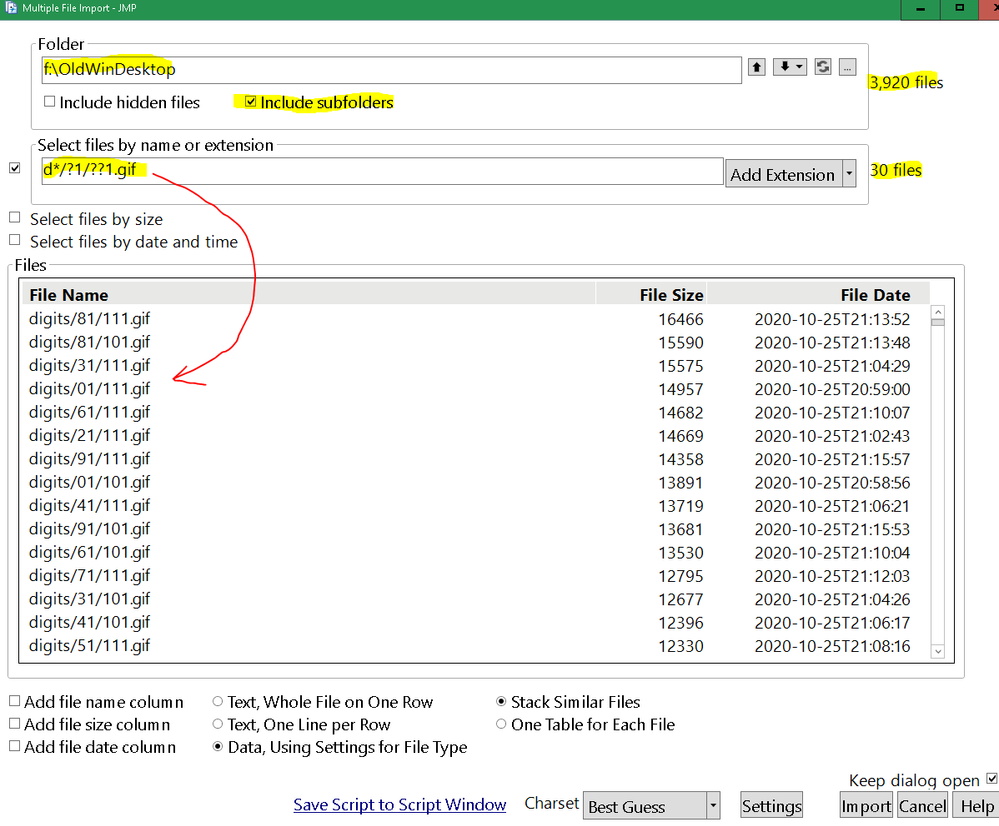

Instead of recursive I should have said Include subfolders. Check the box to get the filter for filenames. The size and time filters can also be used, one or more together. At the right you can see how many files remain. Below I'm using .gif rather than .csv because I found a bunch of old ones in a folder tree.
wild cards: * matches 0 or more and ? matches exactly one.wild cards: * matches 0 or more and ? matches exactly one.
