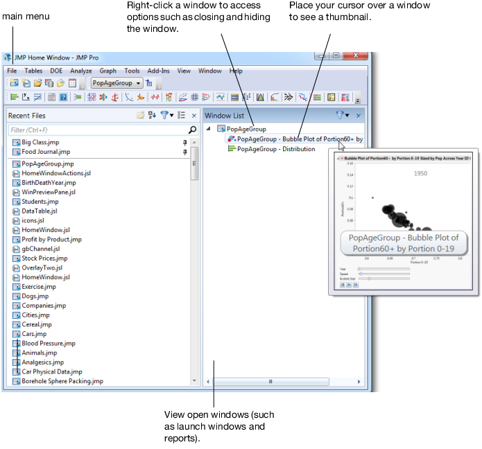

Re: JMP window groups in windows 10
Yes, the Window List can be docked in JMP Home Window. On Windows, the default home window should include the window list and look something like this:
ug_gettingstarted-21

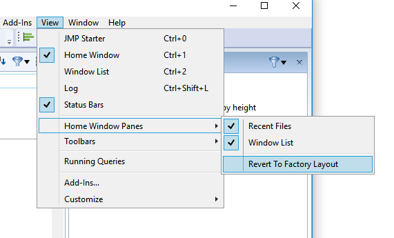

If yours is missing the Window List pane, you can restore it using View->Home Window Panes->Revert to Factory Layout in the main menu:
Thanks, that will make life a lot easier, I must have unticked the window list view at some point.
