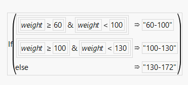

Since I have to retract the original suggestion, perhaps a workaround would be useful.  I would suggest creating a formula column to create the desired overlay categories.  For example:

thanks a lot for ur reponse~!! it works
