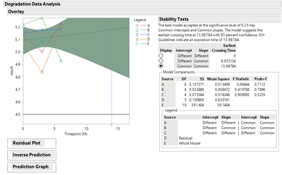

Hello

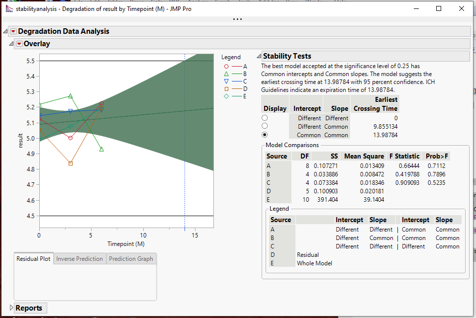

I have a response with two sided specification limits entered as Spec Limits in Column Properties, and tick mark in "Show as Graph Reference Lines". When I make a Reliability and Survival->Degradation->Stability analysis, I get an earliest crossing time of 13.99, were USL is crossed. However, USL is not shown in the overlay plot - only LSL is shown.

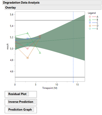

I would like to see both specification limits in the overlay plot like in the figure below (where I have manually changed the y-axis)
Do you have a trick, where I can force JMP to display both spec limits in the graph? I am using the graph in a script, where I loop through a lot of parameters, so I prefer to avoid changing the y-axis manually.
Data and script is attached. I am using JMP 15.0.

Very close to txnelson's solution:
Names Default To Here(1);
dt = Current Data Table();
deg = Degradation(
	Y(:result),
	Time(:Name("Timepoint (M)")),
	Label(:Batch),
	Application(Stability Test),
	Connect Data Markers(1),
	Show Fitted Lines(1),
	Show Spec Limits(1),
	Show Median Curves(0),
	Show Legend(1),
	No Tab List(0),
	Set Upper Spec Limit(5.5),
	Set Lower Spec Limit(4.5),
	Set Censoring Time(.),
	Show Residual Plot(0),
	Show Inverse Prediction Plot(0),
	Show Curve Interval(1),
	Inverse Prediction Interval(Confidence Interval),
	Inverse Prediction Alpha(0.025),
	Inverse Prediction Side(Lower One Sided),
	SendToReport(Dispatch({}, "Reports", OutlineBox, {Close(1)}))
//get upper spec limits from result column column properties
uslValue = (Column(dt, "result") << Get Property("Spec Limits"))["USL"];
//scaling to make limit visible
uslScaleFactor = 1.01;
//Degradation as report
rep = deg << Report;
//access y-axis
reportYAxis = rep[axisbox(1)];
//current max value
currentYMax = reportYAxis << Get Max;
//set as max of either old max or USL
reportYAxis << Max(Max(currentYMax, uslValue*uslScaleFactor));
-Jarmo

Thanks. Great work around. Works perfectly in my script.
Peter
