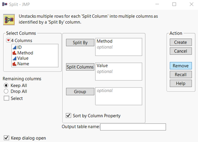

However using the split function:

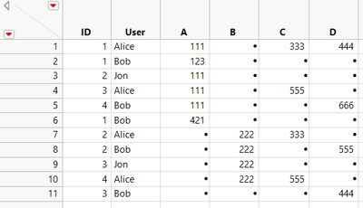

Which gives me wrong results:
For example, ID = 3, B = 222 was done by Jon, not Alice. So the values for ID and Name don't always match the value in the method columns.
Is there a built-in way of achieving this? It appears to be a fault with the split function.

Hi Augustin,
In the dialog launch menu, cast the "ID" and "Name" columns into the "Group" role.
More information can be found on the split function here: https://www.jmp.com/support/help/en/15.1/index.shtml#page/jmp/examples-of-splitting-columns.shtml
Cheers,
Brady

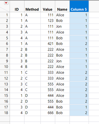

If you did not have duplicate values for ID and Name, you could place them into the Group selection box in the Split platform, and get the results you want, but because you have two entries for Bob in ID group 1, you have to create a new column that will differentiate for that.  So how I did that was
  1. I sorted the data table by ID and Name
  2.  I created a new formula column called Count and used the formula
    If( Row() == 1, counter = 0 );
    If( :ID == Lag( :ID ) & :Method == Lag( :Method ) & :Name == Lag( :Name ),
    	counter++,
    	counter = 1
    counter;
  4.  I then Split the table using ID, Name and Count in the Group selection boxsplit2.PNGsplit2.PNG
Please note, that I keyed in an incorrect value in the original data table for Bob of 1223 and it should have been 123

Oh, good catch, I did not see that duplication. In that case, yes, you need another column.
The way I create that new "differentiator" column that txnelson mentions--without lags, so you don't have to sort the table--is with the formula:
col cumulative sum ( 1, :ID, :Method, :Name)
Cheers,
Brady
