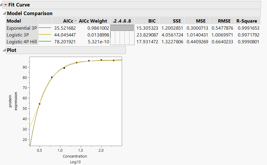

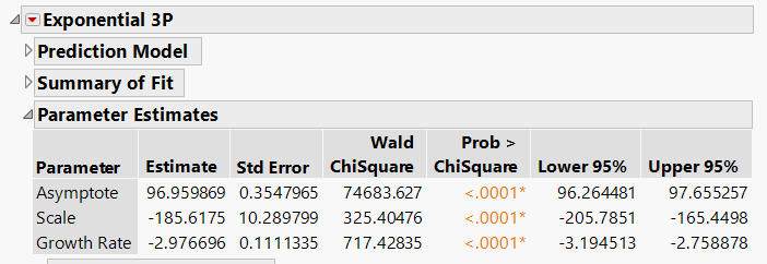

To add to @Chris_Kirchberg, I wonder if you actually need a logistic model at all because your data is essentially an exponential growth curve.
See below the comparison of the Exponential 3P, Logistic 3P, and Logistic 4P Hill models: the Exponential 3P model is the most effective at describing your data (lowest AICc).
