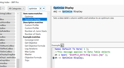

ErraticAttack
Level VI
Re: JMP Scripting Collapsing Whitespace in All Columns
Try sending the message <<Optimize Display, as shown in the Scripting Index

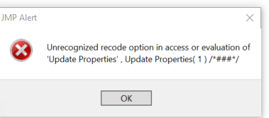

This is exactly what I'm looking for, but it didn't work for me. I got the error message below when I tried the script.

Joseph_Reese
Level IV
@dn610  You may not be using JMP 16. I have noticed that when using the Recode script, in version 16 that line for Update Properties gets added. If you just delete that line for update properties the code should still work for earlier versions.
dn610
Level III
 I'm using JMP 15, and that's exactly what I did to make it work. Thanks again!
