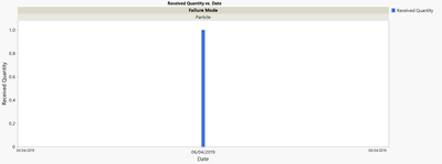

I created a graph to show the number of claims received by date.
For this case there is one claim received on the 24th June 2019.
Why is the bar not indicating the right date but showing an interval (even though bar style is side by side and width proportion is 0 )?  How to change it to show the exact date? Needle bar style is not an option as the bar is too thin and not easily readable.
Thanks.

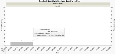

Have you tried to change the date column to "nominal" instead of "continuous" data?

Yes i tried that but the problem is that i need to have the x-axis as continuous dates incremented by month.

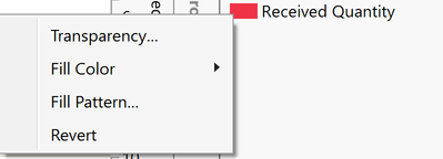

Those are the options i see when i right click on the legend:
None of those changes the width.

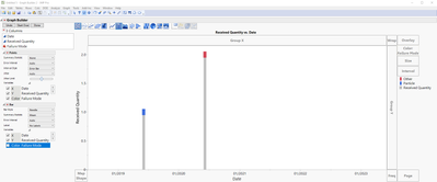

That is a good point and I can understand the challenge. Here is one additional item to consider. You could add a Marker element to your graph and only have that be the element that is colored by your variable. Then adjust the width of the needle bar and marker sizes/types to suit your preferences. I am going to call this a Matchstick plot since they look like little matchsticks:)
