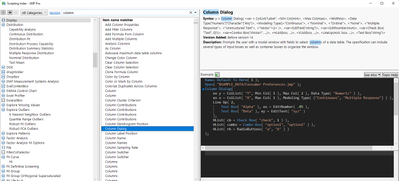

Re: JMP SCRIPT: Creation of a graph based on a user selection variable
The Column Dialog() command allows users to select columns for roles in later analysis. You should be able to delete/modify from the example from the scripting index to get what you need, i.e., just keep the things relating to the "Y" column.
