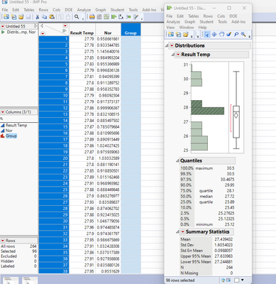

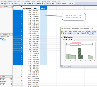

When I select desired rows through distributions, how to quickly batch input “Group A” into Group column?

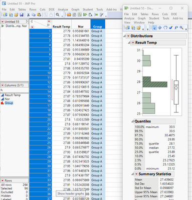

  1. Select the rows from clicking on the Histogram                                   txnelson_0-1679551852708.pngtxnelson_0-1679551852708.png

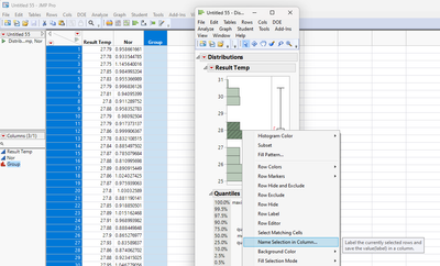

  2. Right Click on the chart and select Name Selection in Column                  txnelson_1-1679552005787.pngtxnelson_1-1679552005787.png
  3. In the dialog window that pops up, specify the column to use, and the value to give to the selected rowstxnelson_2-1679552128142.pngtxnelson_2-1679552128142.png
  4. Click on OK and the cells will be filled in                                                                                  txnelson_3-1679552214438.pngtxnelson_3-1679552214438.png
