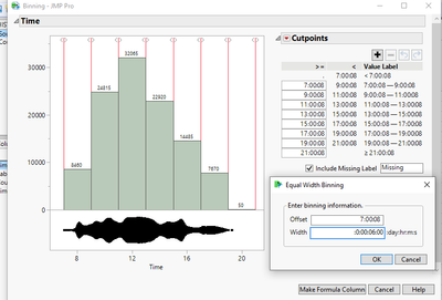

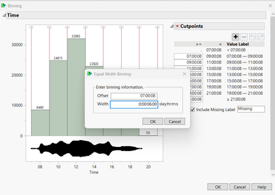

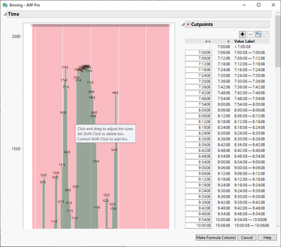

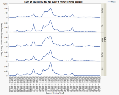

I understand better your situation, and it shouldn't be too difficult to do it with binning :
  1. Right-click in your column time, "New Formula Column", "Distributional", "Custom Binning".
  2. There, click on the red triangle next to "Cutpoints" and click on "Fill using Equal Width Bins..."
  3. Specify your offset and Width (every 6 mintues):
  4. Click on OK ; a new column "Custom Binning [Time]" has appeared.
  5. Right click on this new column, "New Formula Column", and then "GroupBy". You can also do this on your "Label" column (day) if you want a count for every 6 minutes for each day. Without this second column as groupby variable, the sum will only be done for each timeframe, no matter the day.
  6. Then, right-click on the column "Count", "New Formula Column", "Aggregate" and then "Sum". This will create a sum column of "Count" for every 6 minutes and by Day if you have chosen the two Groupby variables (Sum[Count][Custom Binning[Time],Label]) and the JSL formula is
Col Sum( :Count, :"Custom Binning[Time]"n, :Label )
If you have only selected the 6 minutes timeframe for your sum formula column, the JSL formula will be :
Col Sum( :Count, :"Custom Binning[Time]"n )
I hope I did understand better your question and that this answer will solve your question.
I attached the datatable with calculated column and graphs.
Victor GUILLER

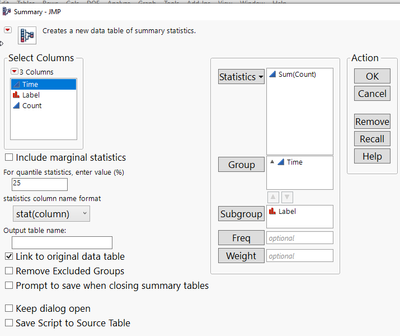

you could use the Summary Platform to sum the counts for each time and day:
If you take time as it is, there is just a single entry per time step and day, therefore, it doesn't matter if you use mean, sum or median

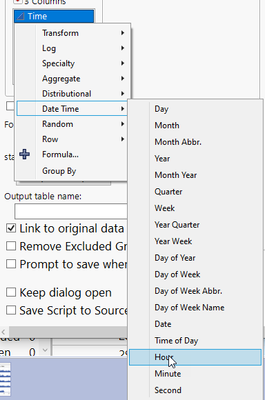

By right clicking on time, you could change the aggregation -  to e.g. to calculate the counts vs. hours. Then Sum will make more sense.
Data Table( "HISTOGRAM DATA" ) << Summary(
	Group( :Time ),
	Sum( :Count ),
	Subgroup( :Label )

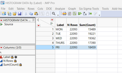

If I understand well your case (doing a sum of column count by day), here might be several options to do this, here are two :
  • Formula column : You can create a formula column of the sum of counts by day. To do it so, right-click on "Label", "New Formula Column", and then "GroupBy". Then, right-click on the column "Count", "New Formula Column", "Aggregate" and then "Sum". This will create a sum column of "Count" by "Day" (Sum[Count][Label]) and the JSL formula is
    Col Sum(:Count, :Label)
  • Table Summary : You can also create a summary table, to aggregate the sum of count by day. To do so, go into "Tables", then "Summary", use your "Label" as group variable, your "Count" and statistics Sum as "Statistics" variable, and click OK. you'll have a small table aggregating the values of count by day :
JSL code to create this table is :
// Data table summary
	Group( :Label ),
	Sum( :Count ),
	Freq( "None" ),
	Weight( "None" )
I hope I did understand well your goal and that this response will help you,
Victor GUILLER

Great, thanks  a lot Victor!
