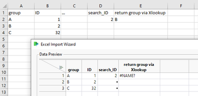

JMP Import: "XLookup" equation in Excel file
Great,
in Excel 365 there is a new "XLookup/XVerweis" *) function
https://support.microsoft.com/en-us/office/xlookup-function-b7fd680e-6d10-43e6-84f9-88eae8bf5929
But  JMP  doesn't seem to understand it (yet). Same at your site?
*) In contrast to the old VLookup/Sverweis, for XLookup the column with the return values can now also be in front of the search values.
No re-shuffling of columns anymore ;)

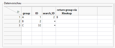

Re: JMP Import: "XLookup" equation in Excel file
The issue is fixed in JMP 16.1.
I just updated my installation and could confirm: working now.
Managed to replicate this with JMP16.0. JMP will return #NAME? for cells with XLOOKUP formula. Attached is Excel sheet with three different formulas: XLOOKUP, SUM and LOOKUP in which SUM and LOOKUP work fine. I would guess that this will be fixed in future version of JMP (but no idea in which).
For a workaround you could recalculate the values after importing the data from excel with JMP formula.
