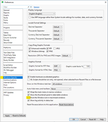

Hello,
I recently upgraded to JMP 17, and I'm encountering a strange issue.
When I open the data table window on the full screen, the script JSL window also opens on the full screen.
Additionally, when I minimize the script JSL window, the data table window is also minimized.
How can I fix this and keep the windows at different sizes?

Re: JMP 17
maybe it will assist to somebody who will meet the same issue
To check the preference, choose File -> Preferences from the menu.  Next select Windows Specific in the list on the left.
