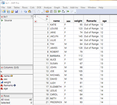

I am not finding an error with your code.  I adopted it to a couple of sample data tables that I have attached, and it works without error.
names default to here(1);
dt1=data table ("bc1");
dt2=data table("bc2");
dt1 << Update( With( dt2), Match Columns( :name= :name, :sex==:sex),
 Add Columns from Update table ( :Age) );
dt1:Remarks << Formula ( If( :age== "12", "Out of Range", "" ));
Check to make sure that my code works on your copy of JMP.  If it does(which it should) then look to see how my sample data table's columns are different from your tables.
