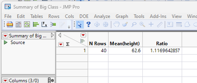

dtSumm = Data Table( "Big Class" ) << Summary(
	Mean( :height ),
	Freq( "None" ),
	Weight( "None" ),
	output table name( "Summary of Big Class" )
dtSumm << New column("Ratio", formula(:"Mean(height)"n/56))

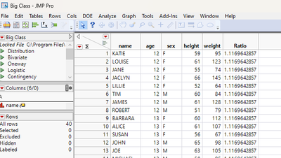

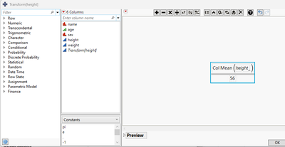

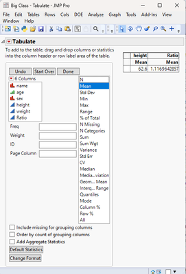

If you are using the Tabulate Platform, you will need to generate the calculated value in the data table, and then display it in the Tabulate output
or create a virtual column in Tabulate and use it in the display
