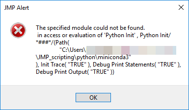

Re: JMP 14 Python abilities - working? I'm confused
Regarding deployment, I think it will be fine as soon as Python does not interfer with other user installations.
For example, I am trying to call Python from JMP 15 EA8 which is in one specific folder.
This folder contains all the instalation files of Anaconda/miniconda, which I copied to a folder before uninstalling it. The code worked when it was installed. Now, it seems that JMP does not use the path I am specifying.
Set Environment Variable( "JMP_PYTHON_MODULE_PATH",
	"\["", "C:/Users/xxx/JMP_scripting/python/miniconda3/python36.zip",
	"C:/Users/xxx/JMP_scripting/python/miniconda3/DLLs",
	"C:/Users/xxx/JMP_scripting/python/miniconda3/lib",
	"C:/Users/xxx/JMP_scripting/python/miniconda3",
	"C:/Users/xxx/JMP_scripting/python/miniconda3/lib/site-packages",
	"C:/Users/xxx/JMP_scripting/python/miniconda3/lib/site-packages/win32",
	"C:/Users/xxx/JMP_scripting/python/miniconda3/lib/site-packages/win32/lib",
	"C:/Users/xxx/JMP_scripting/python/miniconda3/lib/site-packages/Pythonwin"]\"
Python Init (Path("C:\Users\xxx\JMP_scripting\python\miniconda3"),
Init Trace("TRUE"),
Debug Print Statements ("TRUE"),
Debug Print Output("TRUE") );
Python Submit( "\[basket = ["apple", "orange", "pear"]
print(basket)]\" );
Python Term();
Error in JMP 15 EA8
Error in JMP Pro 14.2:
An installation of Python cannot be found on this system. JMP Python support requires Python version 3.0 or higher. in access or evaluation of 'Python Init' , Python Init/*###*/(Path(
