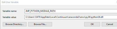

Here's what my latest attempt at environment variable looks like... is this not the right format? (the earlier post looked like environment variable had curly brackets and double quotes like JMP wanted to see is as a JSL list format but this looks like what the 4.2 post is saying to do and other format didn't work for me either...  A python36.dll file really does seem to be in this location... env variable issue.png
Not sure if I'm having a freak problem specific to my system that I need tech support on or whether I just don't get the latest verison of how this is supposed to work.

JMP 15 adds 2 new environment variables that it is looking for:
    JMP_LIB_PYTHON_PATH  - this is the full path to the shared library.
    JMP_PYTHON_MODULE_PATH - Python's sys.path as one would expect in Windows or MacOS enviroment variables.  On windows a semi-colon separated list, on MacOS a colon separated list, NOT a JSL list.
On my machine I have Anaconda 3.7.1 64-bit installed in C:\ProgramData\Anaconda3
that would look like
JMP_LIB_PYTHON_PATH=C:\ProgramData\Anaconda3\python37.dll
The path to the dll should be enough... and should be sufficient that Python Init() can be used without parameters.  With the JMP_LIB_PYTHON_PATH and JMP_PYTHON_MODULE_PATH specified, Python should be fully specified even with more than one Python interpreter and Python Init() should just work.

The order of precedent that JMP  15 looks for the environment variables:
    Order of precedence of the Environment variables and JSL script highest to lowest
  1. Specfied within the JSL script in Python Init( Path(""), Use Python Version(""), Python sys path( { "",... } ), ... )
  2. Specified in the System/Shell Environment variables
  3. Auto located
    - Registry, found on PATH var, or System shell to run python or conda, ... and should prefer a locally installed Python
                   over a system wide install Python if both exist

Given I'm just getting going with python and don't have a special need about 3.7 -  that I know of - I think I might uninstall all of it and start over with another of the options, like an archived Anaconda install package with 3.6. I'll see how that goes.
But seems like this kind of "need different versions for different stuff" is common, as it is for R - it was reading that was the case that made me dive into that more complicated-looking option and the link above wasn't the only place I saw the advice to use a virtual environment.  So wondering if you can say any more about plans to be able to tell it to operate in a particular virtual environment.
The InitTrace("TRUE") thing crashes JMP for me.  But maybe if I didn't have my path involving a virtual environment it would be different. Will work on that and open a Tech Support case for further help.   Thanks!
Re: JMP 14 Python abilities - working? I'm confused
Supporting python virtual environments is something we are looking at.
The flip-side is this question:
Is supporting the varitey of user installed versions of Python is too difficult to get running and keep running?
If so, the solution may be a JMP supplied and installed version of Python that is tested and known to work with JMP without issue. The problems that brings include supporing the install of local packages and extension into a JMP delivered Python environment.
At the moment we would prefer to support the user's installed Python, but as you have experienced the variety in the wild can make that a challenge.
Thanks,
Paul
uday_guntupalli
Level VIII
@Paul_Nelson ,
            I have on ongoing case with Tech Support on this issue - SAS 7612709398.
            I have tried to include the trace as you have suggested and that crashes Jmp. However, I don't see a .dmp file or .jer file being generated that I can provide to Tech suppport.
Best
Uday
Have you verified that your Python and JMP are the same bit-ness. 32-bits or 64-bits. The lack of a dump file indicates JMP is probably going down when it tries to load Python as a shared library. If there is a mis-match 32-bit JMP / 64-bit Python or 64-bit JMP / 32-bit Python, would pretty well guarantee a crash.
That’s something JMP should try to validate before attempting to load, and something that we should be attempting to catch, but it might still be an unrecoverable condition. But it would be good if JMP could give some notification.
Paul
