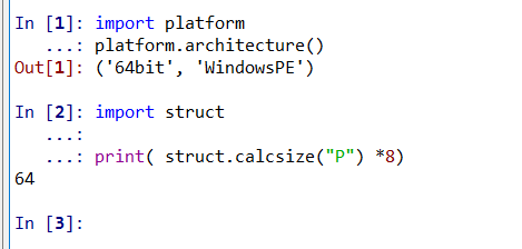

@Paul_Nelson ,
  Indeed. I have checked and validated that both JMP and Python are both 64-bit.
Best
Uday
Re: JMP 14 Python abilities - working? I'm confused
I was hoping for a mismatch and your problems would suddenly be solved.

For what it's worth mine are definitely both 64 bit and I get the crashing as well.  The only time mine doesn't crash on Python Init() is  with the Use Python Version() argument when I get the "can't find" message.
