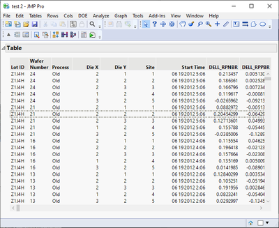

  I have a script that pulls a data table and brings it into a window using the command dt<<Get As Report. This table has many columns and many rows. Unfortunately, it shows up in the window like this, it's really large and I don't want it to be this size:

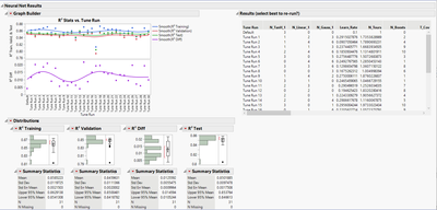

  Instead, I'd like to resize it automatically, to something more like this:

I think you want to fix the size of table box, not outlinebox
Names Default To Here(1);
dt = Open("$SAMPLE_DATA/Probe.jmp");
bb = dt << get as report;
// we need to modify the table box, not borderbox
(bb << child) << Set Scrollable(20, 5); // rows, columns
dt = New Window("test",
	Outline Box("Table",
		bb
-Jarmo

Hi @jthi ,
  Thanks for the quick response and solution. Yes, it was actually the table box I wanted to fix the size of, but nothing I had tried worked, so I thought maybe it was the OutlineBox. Anyway, great solution, thank you!

One thing you might want to change is to change the reference to table box from
(bb << child)
to something like
bb[Table Box(1)]
as it might be more robust option (when building something like this, usually it is a good idea to almost always explore either properties or XML)
-Jarmo
